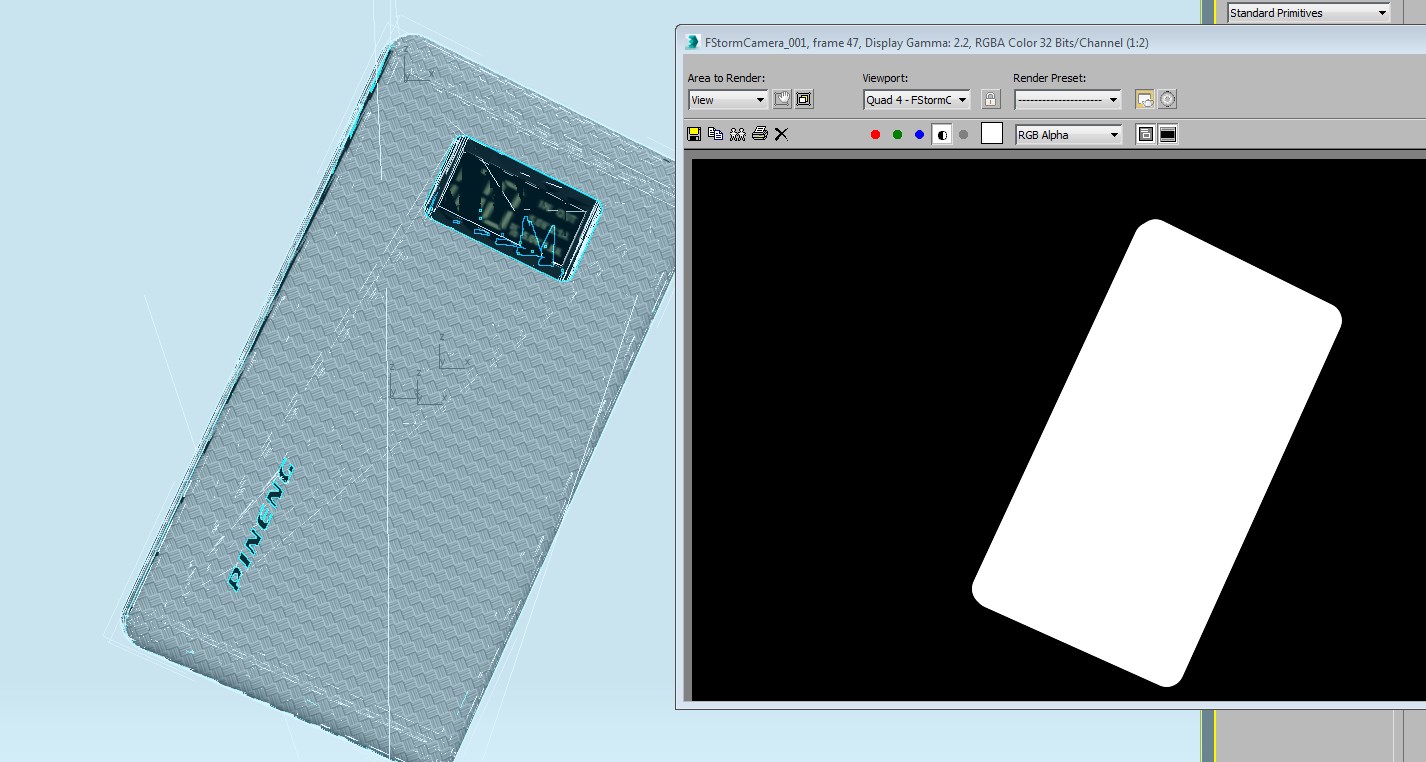

    in render setup menu , i choose selected (on area to render)but i failed render for selected object render.i just want to get render my object without background (i can hide other object but i didnt mean that.i want to get transparent background(such as .png s )so i can send my object render to ps without decoupe .

      yea i try but looks all areas white . did i something wrong?even i succes ,i have about 4000 frames for a short animation. masking 1 by 1 s realy boring for all frames...
        you did not check the process alpha
        it's under the gi clamp

          thnx solved...i am blind sorry i check process alpha than i just grouped objects which i want for maskin added the result is ok even glare is open.
