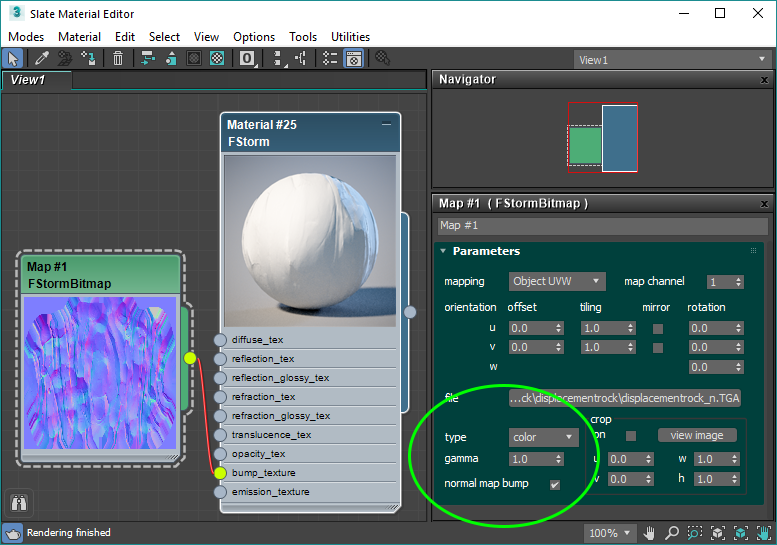

    how i setup normal map in fstorm
    can any one help me ..ples
    thanks for advance
    Connect FStormBitmap to FStorm Material bump channel, set your normal map image as Texture and check the checkbox "normal map bump".

      thanks bro...but It doesn't look correct.icant find green or red channels
    See picture :
