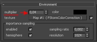

    Hit F10 on the Keyboard -> FStorm Setting -> Enviornment Tab -> Multiplier

      Can I also adjust gamma if I want harsher sun?
