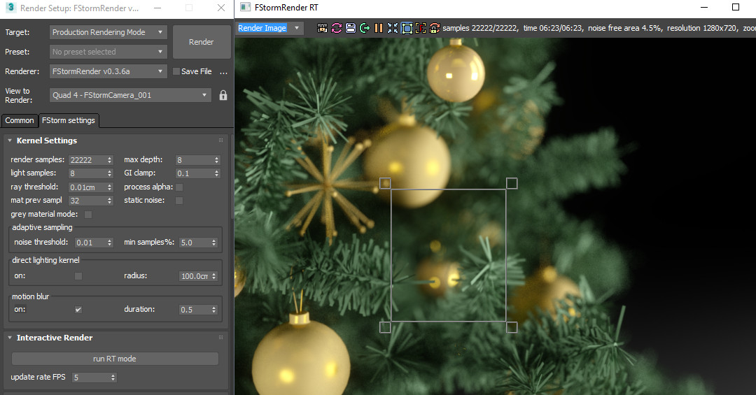

    I'm a 3ds Max / Vray user and I've been following the progress of Fstorm render for a while now (in the background) and thought I would give it a go for a client Christmas animation project. I've stumbled on to my first problem, I can't seem to avoid the fireflies / noise in the image attached. I searched the forum looking for information, I thought reducing the GI clamp might work but it didn't effect it. After my failed search I decided to just get into the settings and literally play with every parameter, cranking the settings high one by one to eliminate the issue. Unfortunately, that hasn't worked either.

    That'd be DOF effect you've highlighted. (there's a DOF override on the camera in your scene;
    also christmas ball materials have light emission on for some reason btw)
    Maybe with more samples (> 1500) noise would clear) or lower dof radius.

      Yeah, it's definitely to do with the dof, I should have mentioned that. I did try upping the samples! In fact, I upped it to over 5000 to rule out that setting.
      In terms of lowering the dof, I'm aiming for that particular look and it would be a shame to substitute creative decisions due to render issues.
      Can you think of any other solutions? Sorry to be a pain! I can upload the scene tomorrow if that would help?
        To start with I'd switch off the emissivity of the material (to avoid light source hotspots/fireflies);
        then render the most affected regions with more samples with 'region render'
        I don't have your HDRI so the result isn't the same but with ~22k samples it looks ok to me (based on the noise adaptivity it still indicates only 4.5% noise free area so perhaps even more could do)

          I don't think render region is a good solution here, the Fstorm philosophy is its strength in Adaptivity, Its MIS, knowing where to sample more.
          You could try raising the minimum samples.
          Otherwise I think this is a scene for Karba to take a look at.

            Well yes but from my quick test the image looked pretty good @1000 samples except those highlighted DOF ares;
            to speed things up (as I have some other stuff to finish I set a render region to apply adaptivity within that small area and there was still noise at 22k samples.
            I believe the adaptivity would eventually transpire across the whole image equally, but this was faster...

          I didnt even even realise I had emissivity turned on, to be honest, it was a vray material conversion. Maybe this has a larger effect than the samples. I'll have a look first thing tomorrow at work and let you know!
