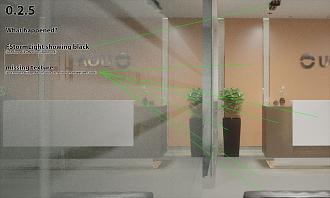

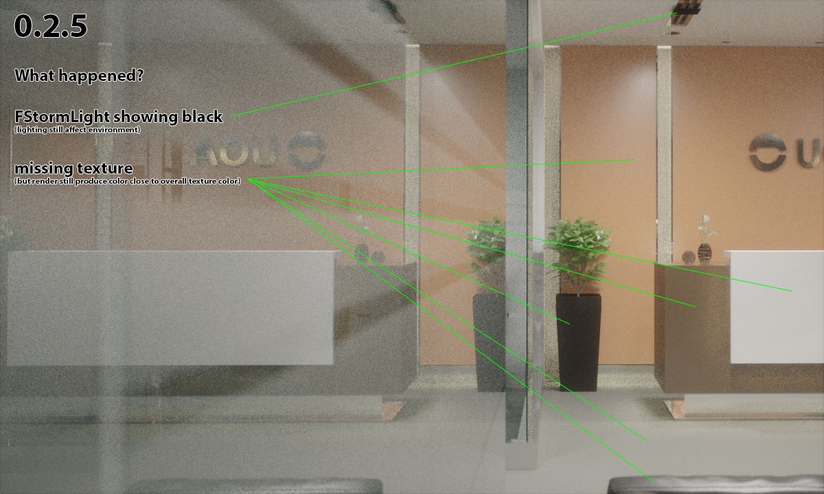

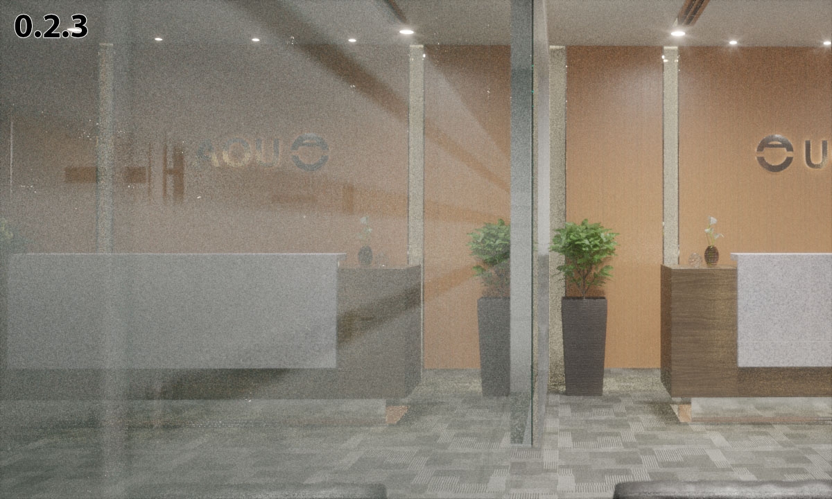

        Hi, I just upgraded FStorm from 0.2.3 to 0.2.5 and dealing with the same issue. Using 3DsMax 2014. Quadro K4000 latest Driver.
ID:	2992 Click image for larger version
          The down light is also not showing because the light uses texture for emission source
            My fault. Fixed. Please redownload 0.2.5 again.
              Everything's good now Thank you for the quick response
