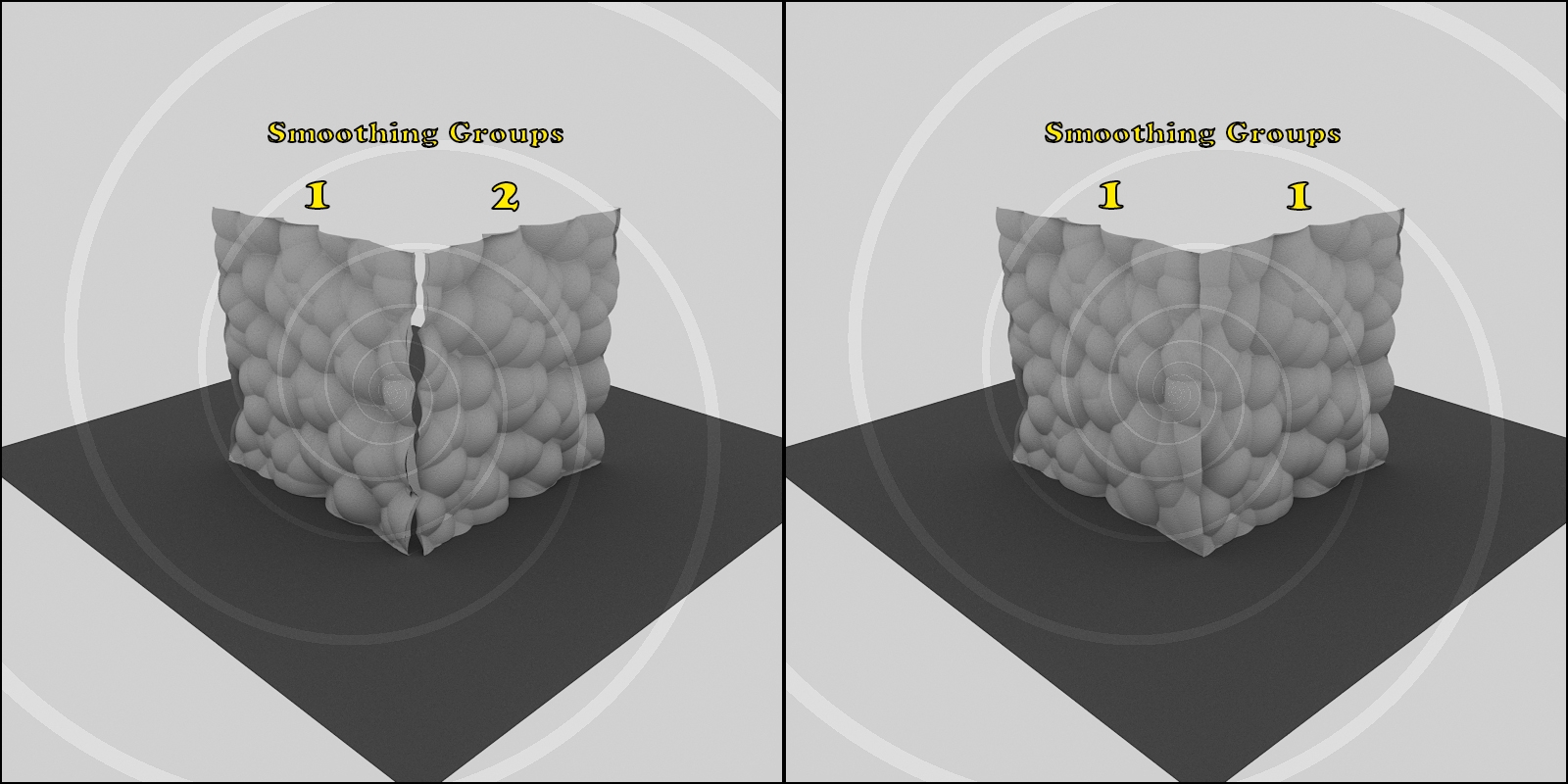

    This feature's already included in FStorm Displacement ; you need to set the same Smoothing Group for the polygons which are supposed to keep continuity :
