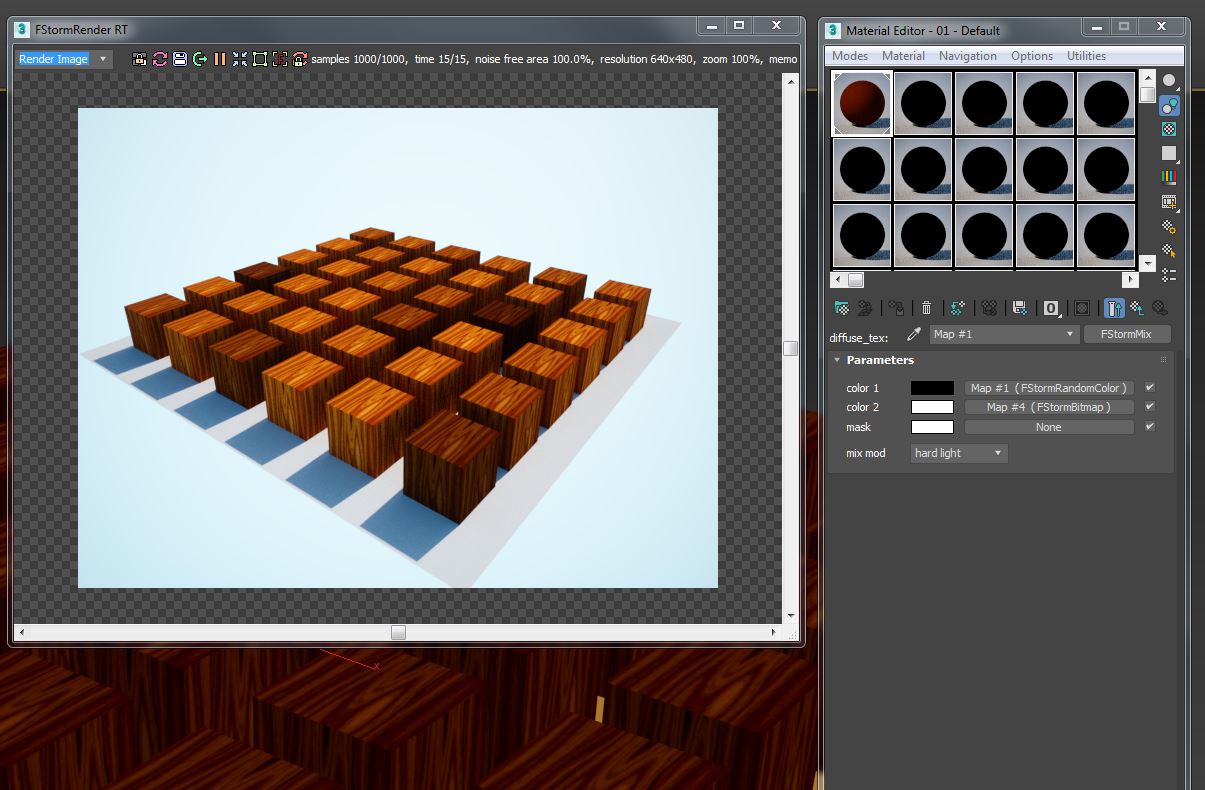

        I think you can do this using fstorm random colour in a mix with the single bitmap.
        Heres one way, you might have to play with the blend mode (mix mod) to get what your after.
          use the fstorm multitex
