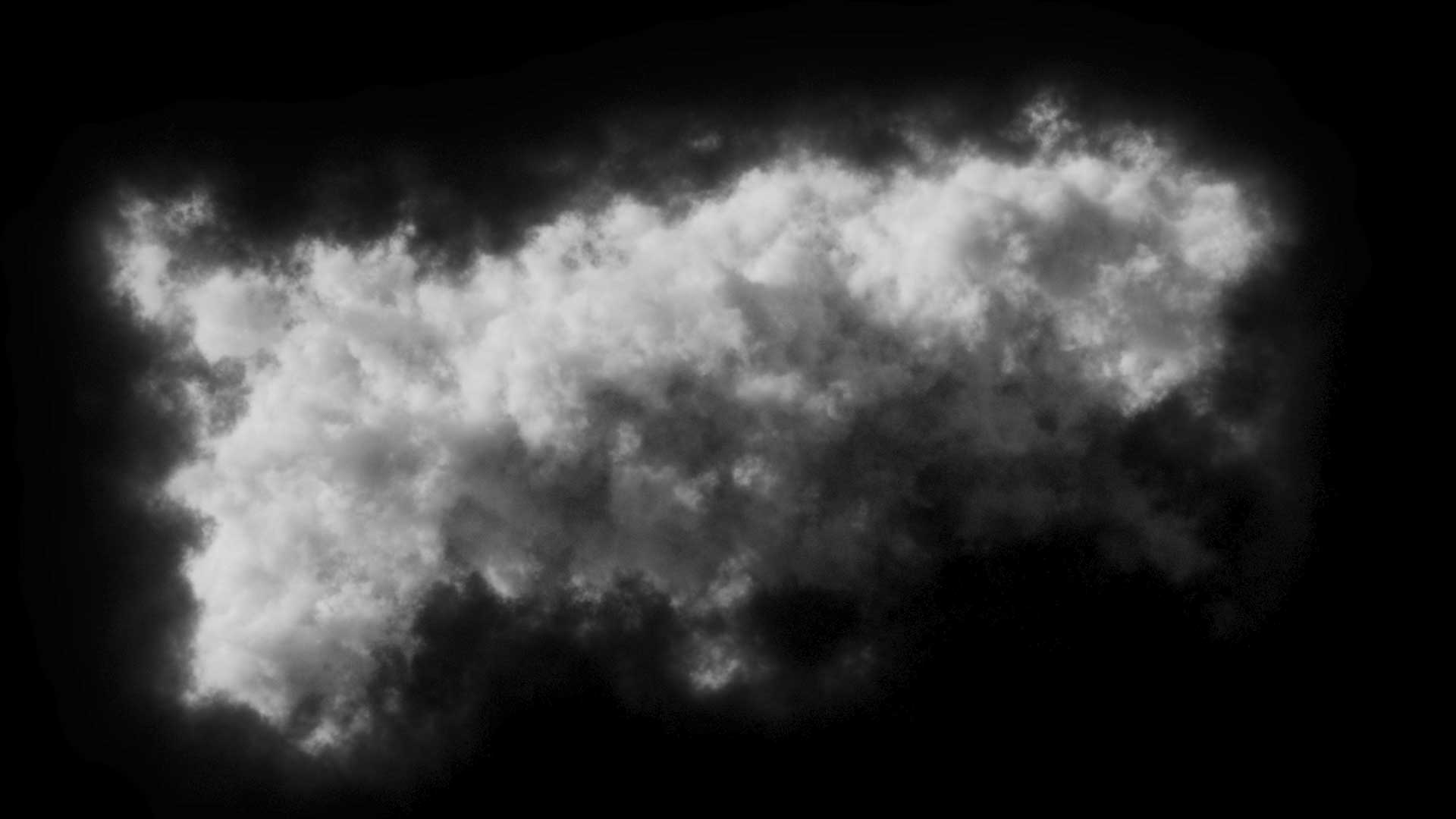

    Softness and "edge transparency" are the same thing. Here I use contrast 15. It keeps details and gives some edges softness. Reduce details threshold to 0.01 so compression doesn't kill much.

    Я там в своем примере неправильно выразился. Надо не edge softness, а edge transparency. Уменььшается не мягкость, а именно степень прозрачности по краям. Но четкость деталей остается. Такое возможно?

    Your solution would do the same. You can play with different contrast values to find some compromise.

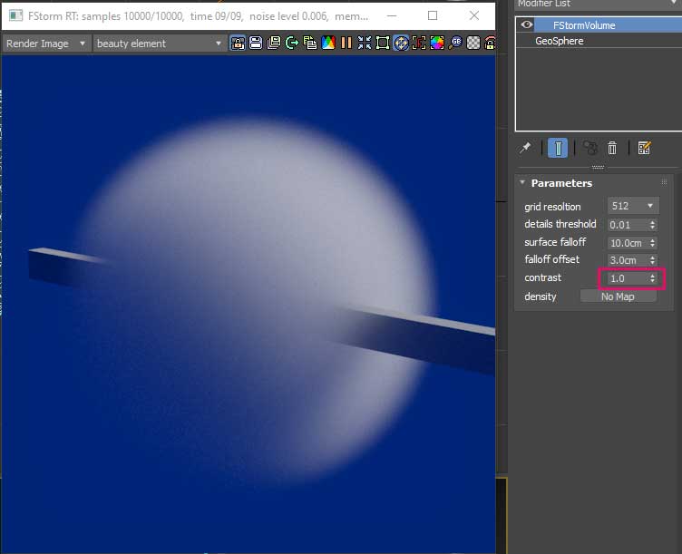

    Thank you! Well, yes, it works with simple fog, but when it comes to some details like clouds, this option destroy all the details.

    Hi. You have to reduce contrast value in FStormVolume modifier.
