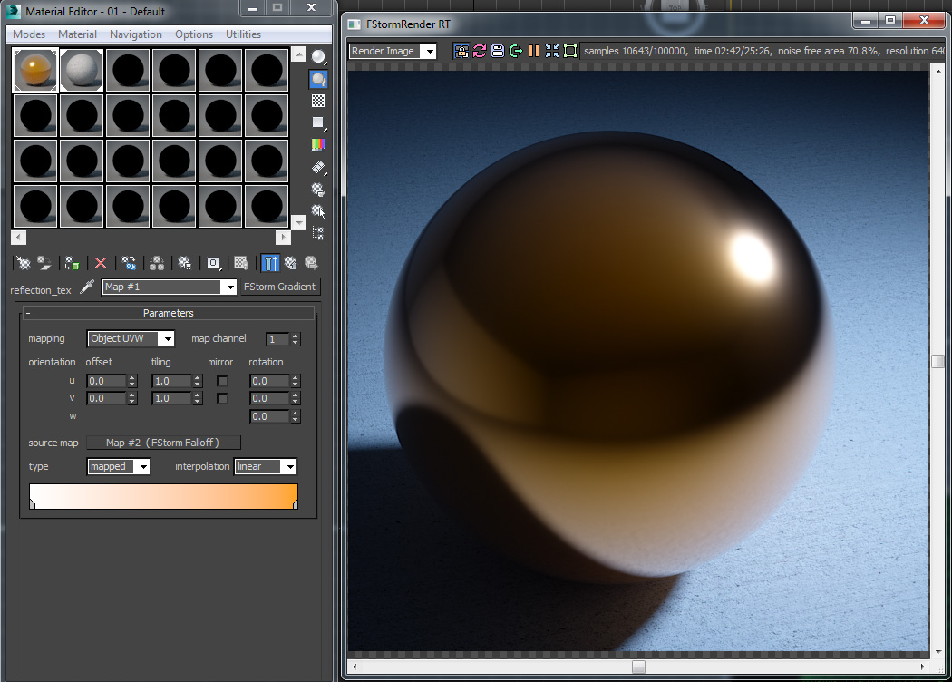

    while I tested yesterday fstorm for the first time I noticed that complexfresnel map wasn't supported. Sure you can use the fstorm falloff map to create simple metalls like alumium or chrome however I don't get how I can create gold since there is no rgb mode.
    Can someone point me in the right direction?
    Much appreciated
    deC9r
    You can create fstorm gradient with mapped mode, connect falloff and set any colors you want
      thanks for the quick reply

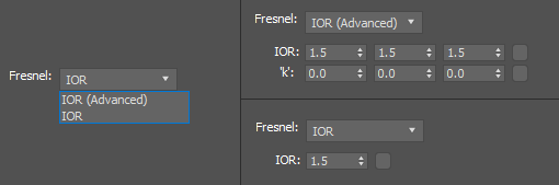

        The Redshift 2 approach would be a great addition to fStorm
          [ATTACH=CONFIG]n1485[/ATTACH]
          that's exactly what I'm hopping for, it makes things so much easier and less of a guess work.
          Test render looks good so far.
