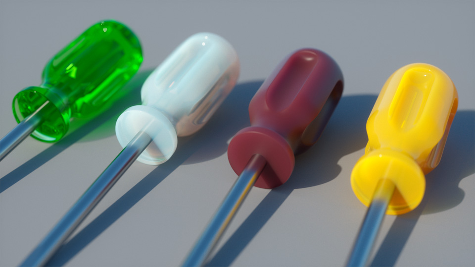

    Many of you are asking about how to setup sss material.
    Here is an example scene
    SSS Scene
    Let me know if it is still unclear
    The scene did the trick, now i understand perfectly how the effect works .
