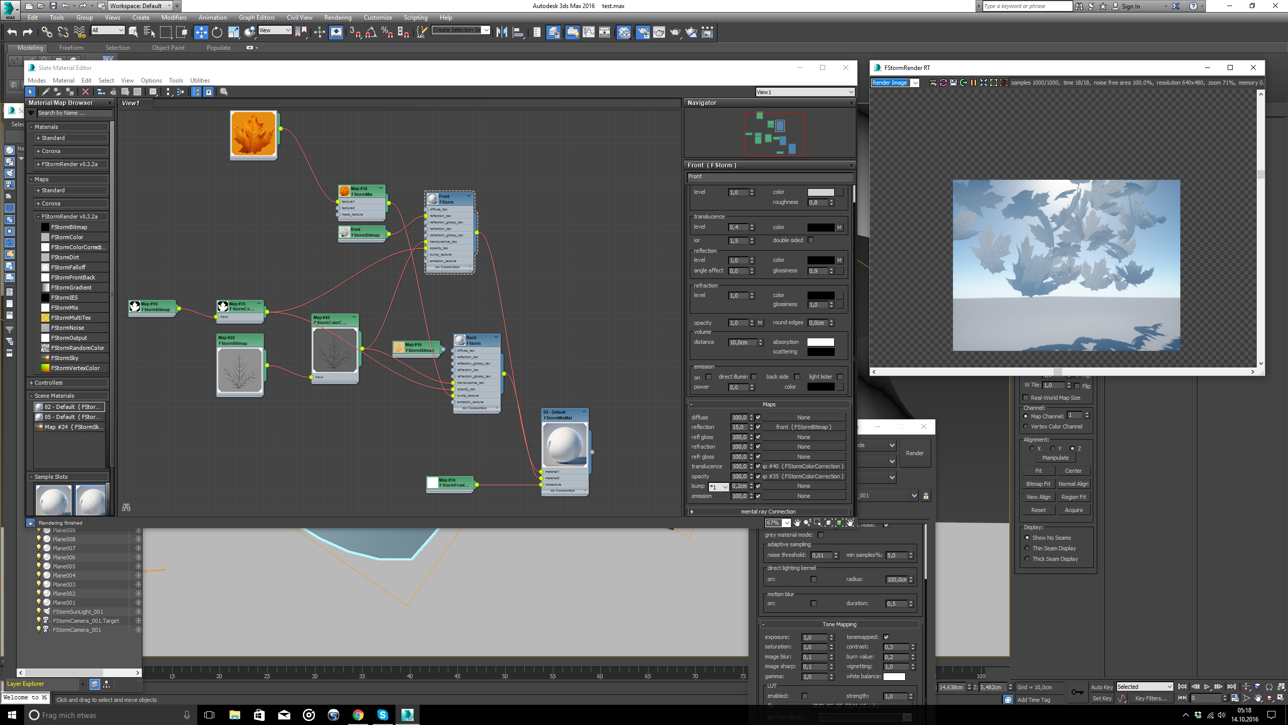

I'm not sure if someone has asked this before, but is there a way to make leaves look good from underneath? By that I mean, does anyone know of a good way to get this subsurface scattering look? (For some reason the attached link isnt working, so here's the original: http://farm4.static.flickr.com/3659/...61cfd96fd7.jpg)
Good Looking Leaves

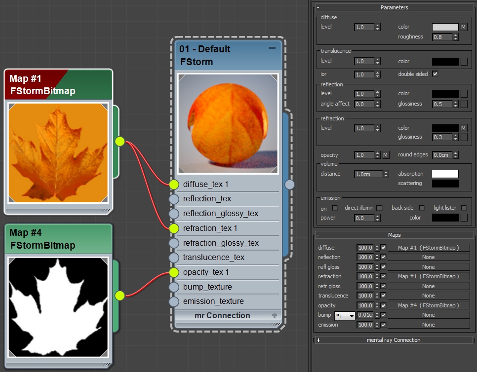

Use FstormFrontBack and a translucency map. If you don't know how 2sided material shaders are generally created I encourage you to watch a tutorial video from other render engines since the main steps are the same.

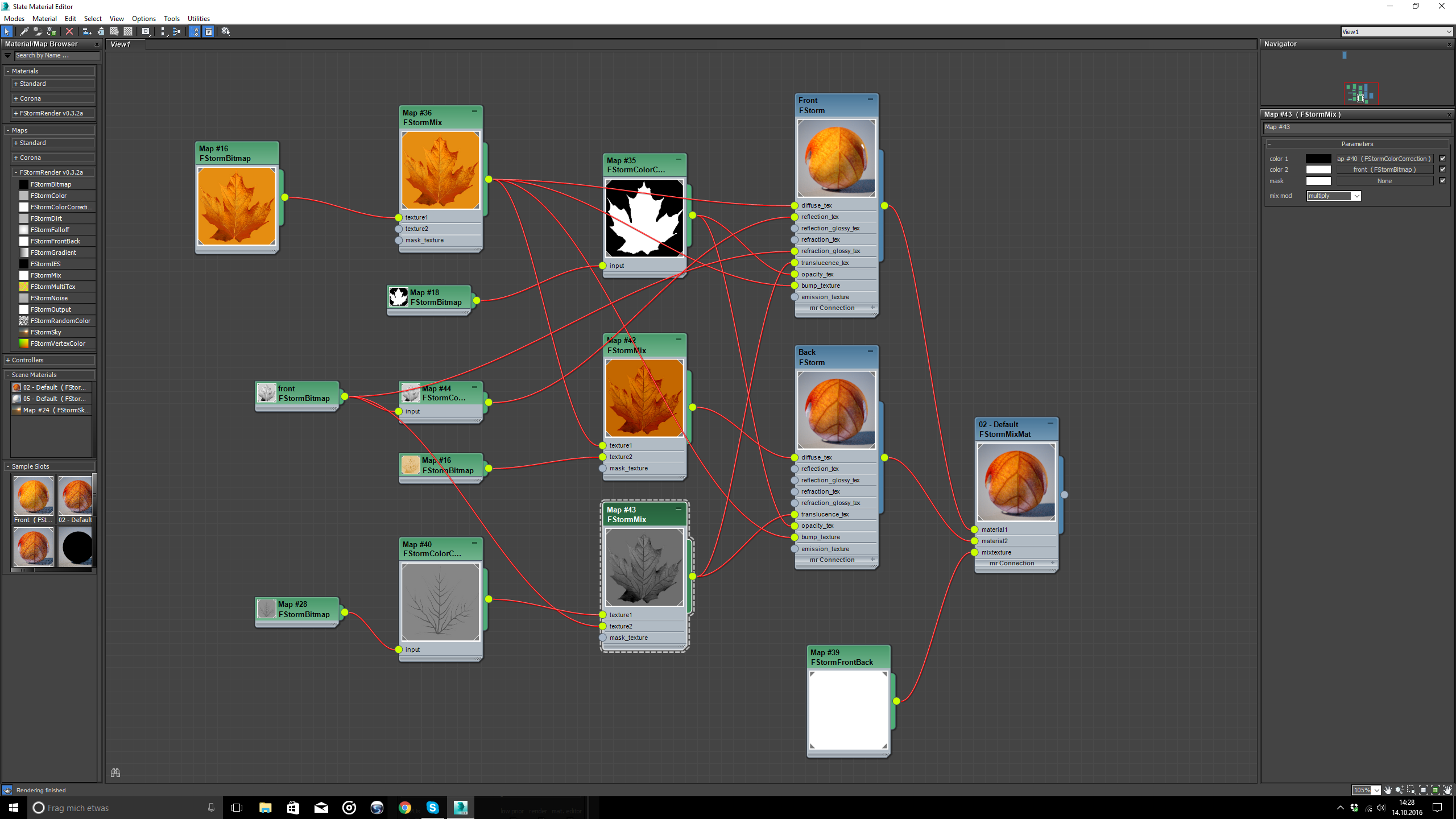

I'm attempting to set up a proper leaf material

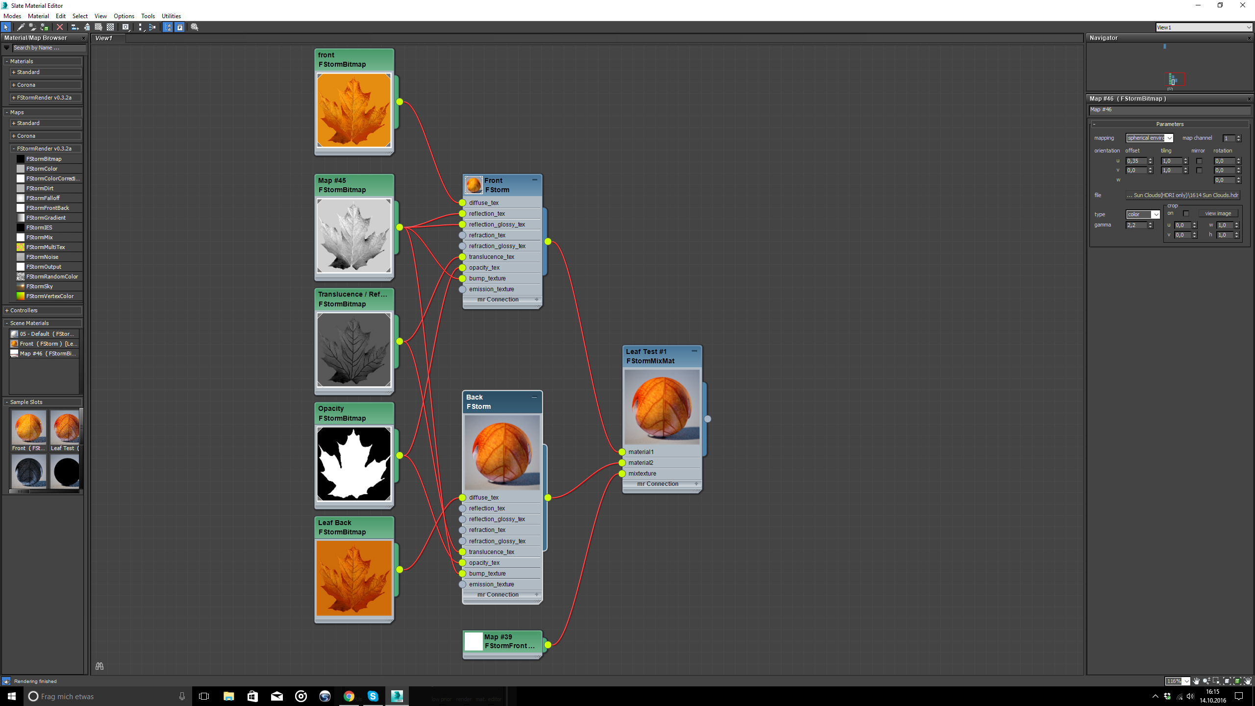

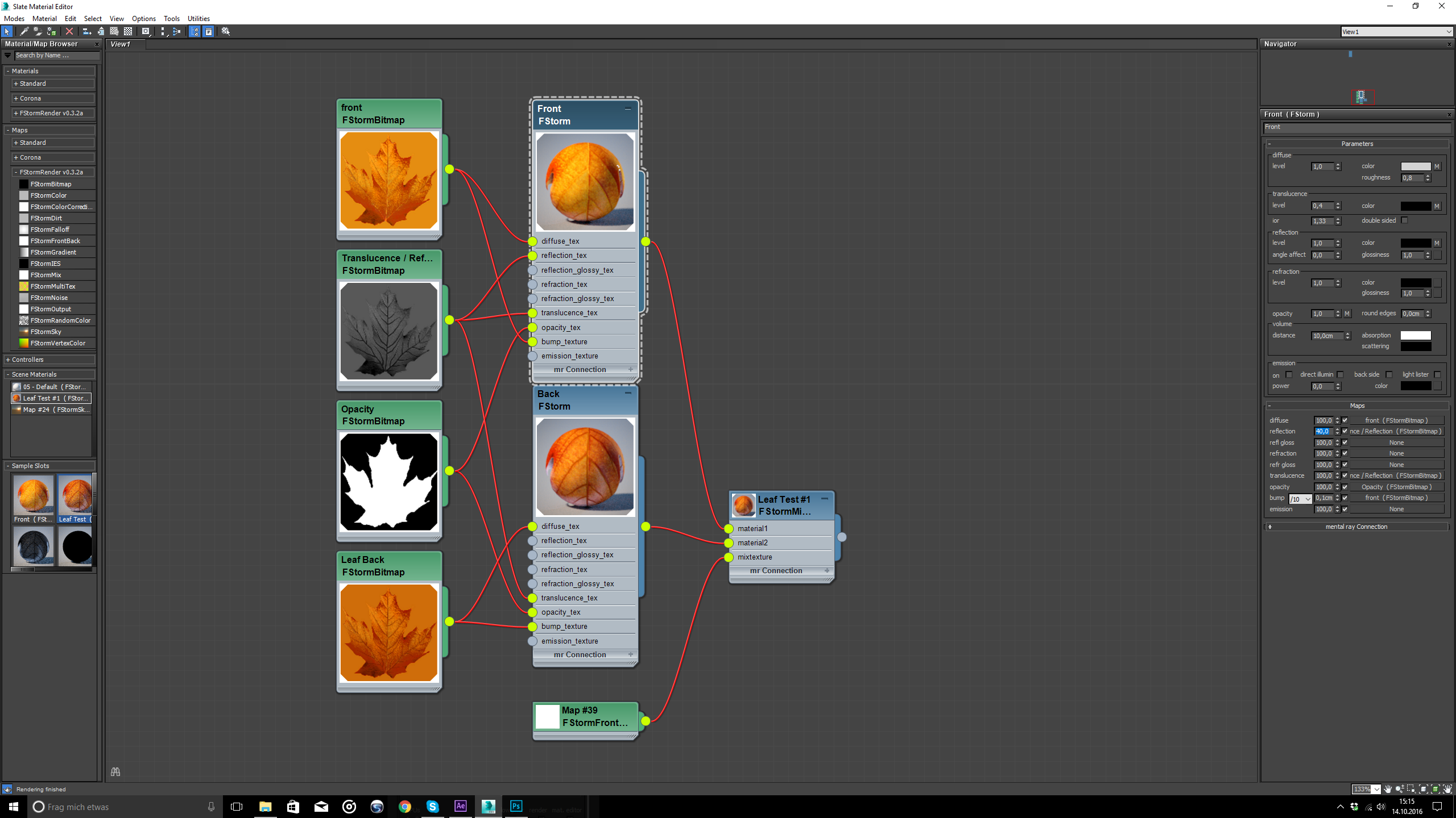

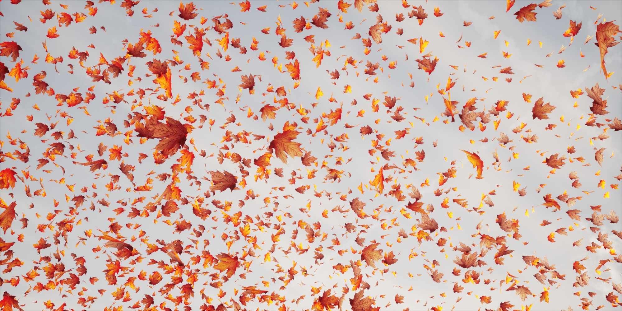

Could you elaborate on the use of Translucency node? Translucency in fstorm seems to work in an unconvential way, here is the problem:
I set a FrontBack material; both the front and the back material have a 'grey' mapped in their Refraction (test A), and Translucency (test B).
Why does the Translucency comes out blurry?? From the fstorm manual: "translucence works like a refraction with zero glossy"
Should both test come out approximately similar?
Thanks

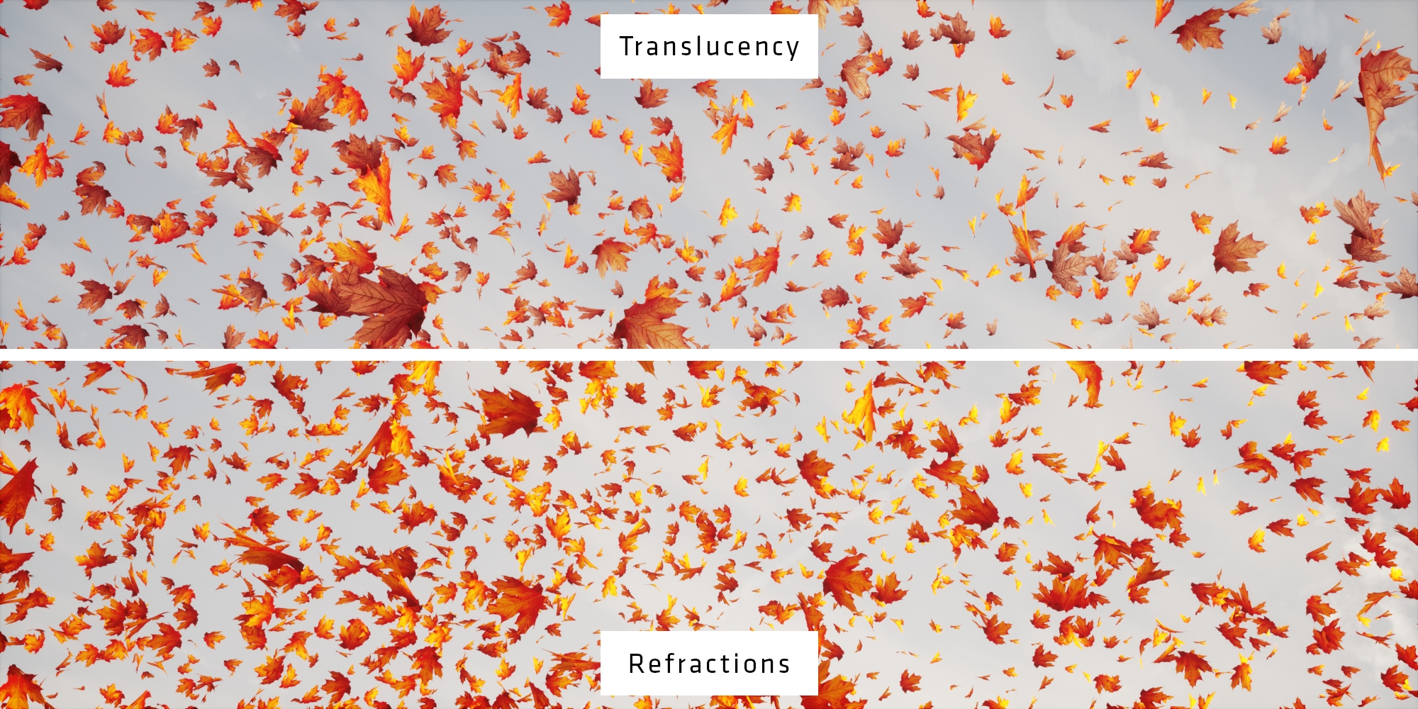

Thanks to deC9r as well, I agree with you, translucency seems to preserve better details, especially with a proper bitmaps.

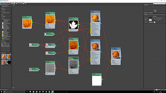

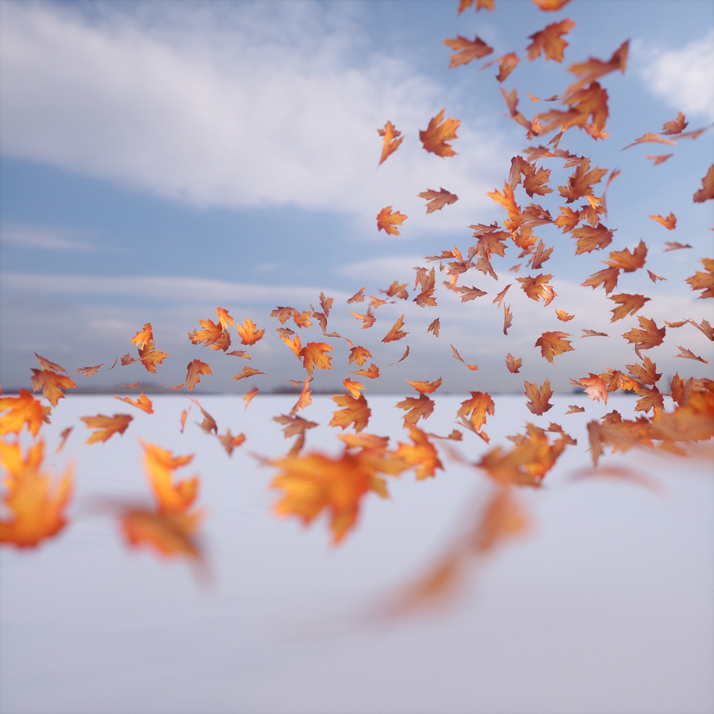

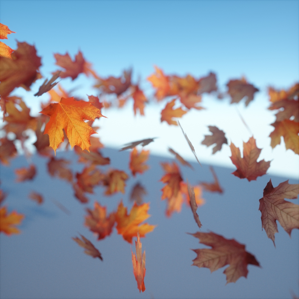

Here is my attempt at foliage. Still need tweakings, will post a complete final scene once I'm satisfied/Last edited by zchenmtl; 10-15-2016, 02:18 AM.
Because I used printscreened textures from your post. They are low res.Originally posted by deC9r View PostYou loose quite a lot of details. However the effect looks really good. Btw I think the reflection on the translucency version is currently the problem. Render times are pretty much the same.
added a translucency version without reflection.
