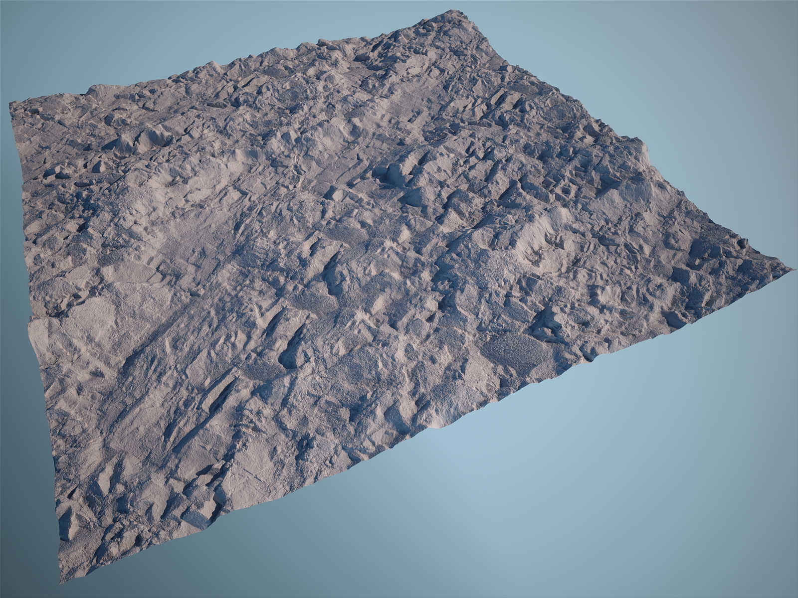

    Hey guys,
    Regarding displacement subdivision, this's what written in the news section : "FStorm displacement doesn't do geometry tessellation and uses very few gpu memory."
    So my question exists : How does FStorm Displacement is working for a single-polygon plane, if it does not add geometry??
      Here is a single displacement primitive made from single polygon plane
