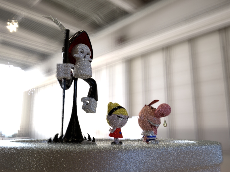

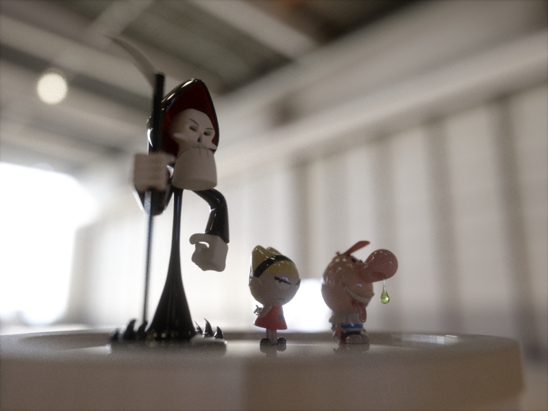

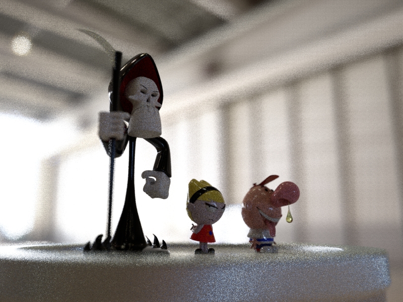

here you go for the sake of comparing with fstorm. And cant find ANY comparison on the web. All pics are rendered for exactly 1 minute.
1st one is fstorm
2nd one is maxwell CPU
3rd one is maxwell GPU
You guys notice how bad the gpu looks? And they stated its suppose to look exactly the same is you render in cpu or gpu. what a shame.
