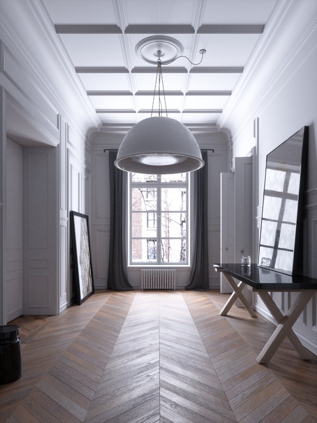

    Hello ! Somebody makes a comparison Fstorm RedShift entirely on one and the same scene? It would be interesting to know the results .. Particularly interested in the difference in speed, light shadows and other things.

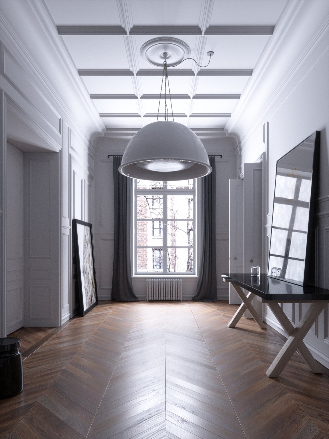

              Ok, first of all, there's a portal in the scene (max 2016 version for sure) but...this epic fight can't be closed with a simple "use the light portal!"
              104 min v 7.54 min (nearly noise free) can't be an usable result (maybe?) so...redshift users that use fstorm too could better compare pro and cons of these two renderer.
              My profane opinion: incredible time render speed for redshift (GI light seems not so good) and incredible light/tuning for fstorm (fast but not fastest).

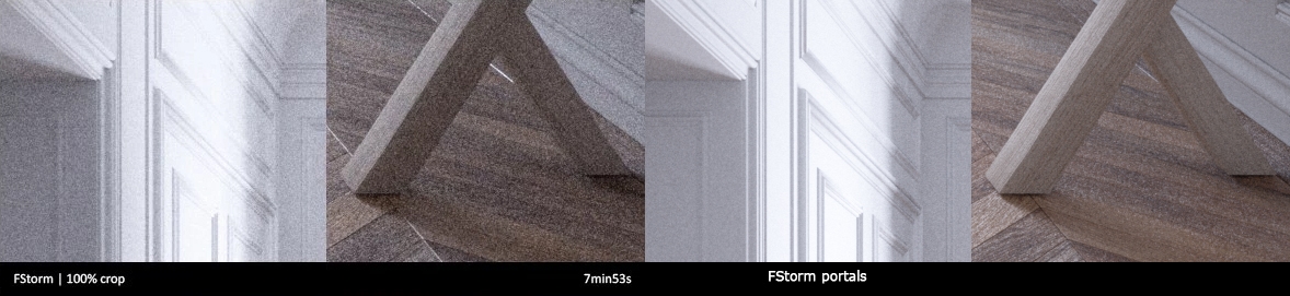

                  What I changed is GI clamp to 0.2, noise threshold to 0.02 and remove environment importance sampling (useless with constant environment)
                  GI clamp 0.2 is the reason why it has so less noise in my render then. it decreases render time from 104 minutes to about 30
                  The main difference is FStorm doesn't use any interpolation like Light Cache.
                  VRay and RedShift use Light Cache.

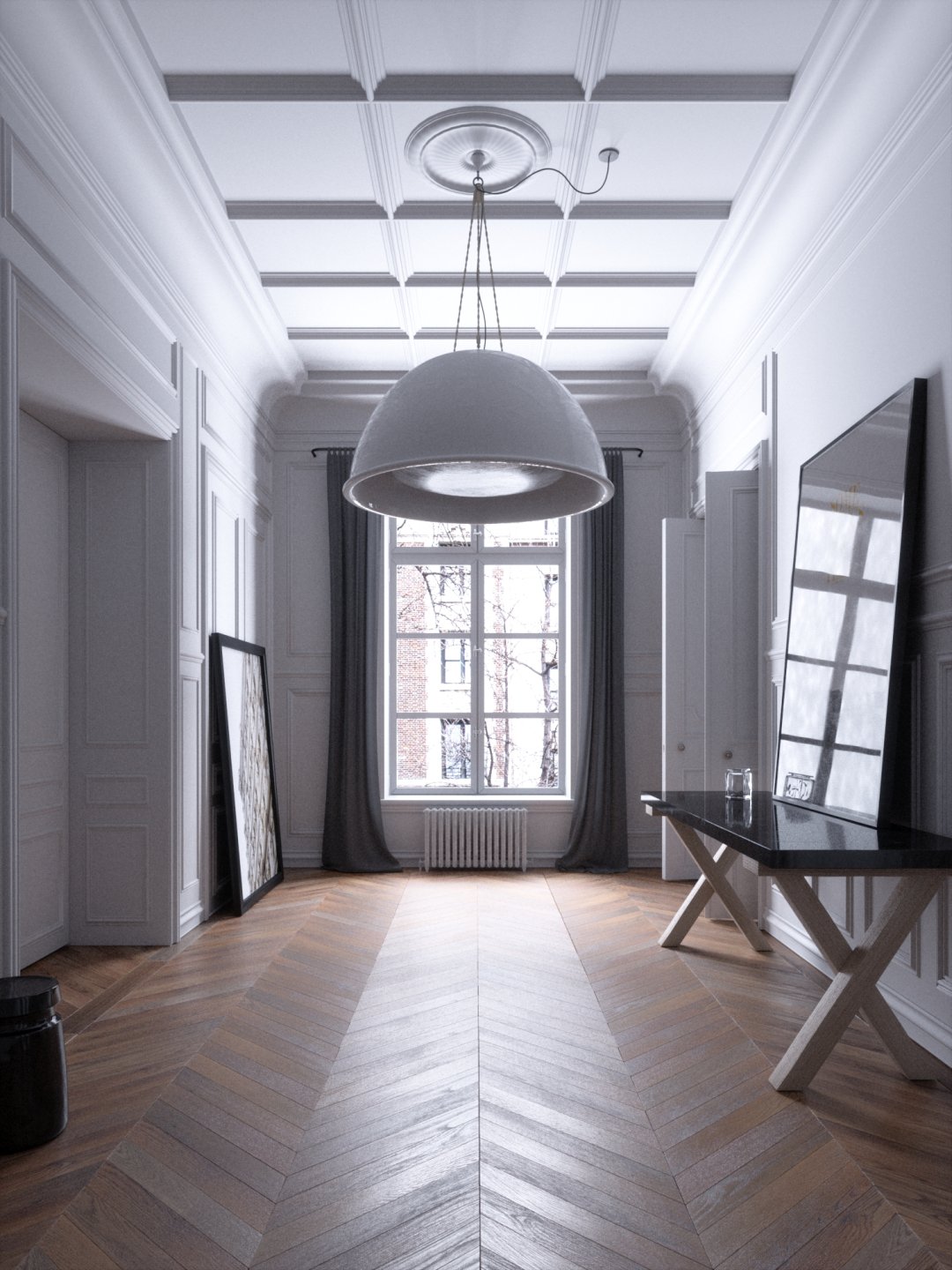

                      bump map on the floor adds too much noise imho (slow-down?) + visually I even prefer it without (there may be a midde-ground found there...)
                      Click image for larger version
ID:	8370 Click image for larger version
                      (both images are 7m53s on gtx1070 as in the write-up, only resized (h1440) for the forum)

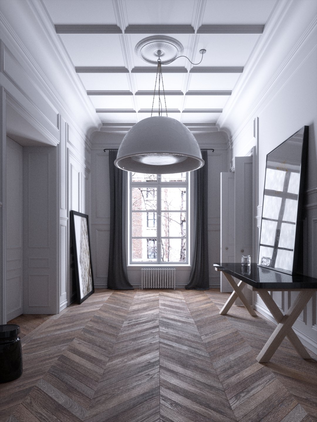

                        maybe could you try to lower the bump amount?

                          1mm bump | 0.5mm bump (7m53 ~315samples)
ID:	8381 Click image for larger version
                          6000 samples finished in ~25m
